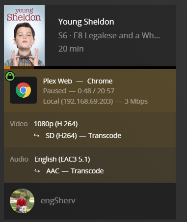

as you see in this screenshot
HW transcoding isn’t working

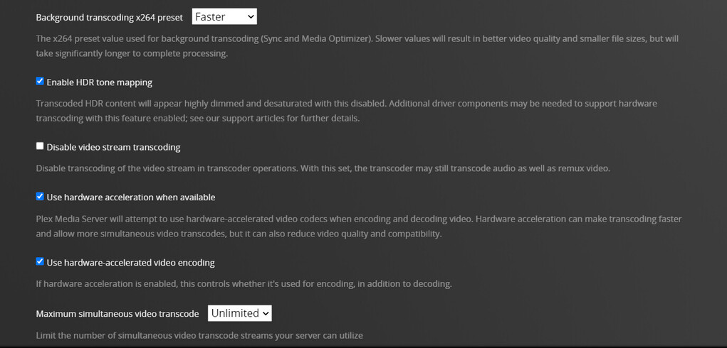

my transcoding setting
