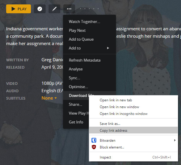

You can even play AV1 using a remote Plex server. Trick is to start downloading the file, then copy this link to your mpv instance. Runs flawlessly. Another feature I’m really missing from both Emby and Plex (but Jellyfin has this) is “copy link” instead of being forced to start downloading the file.

@aaaaaaaaa oh boy, it’s your lucky day. I’ll leave you with this.

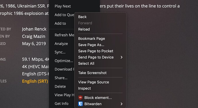

Funny enough this option is not available to me, because “Download File” is not an actual link but an event in my Plex instance (app.plex.tv and local):
And thus I can not just copy a link:
(Chromium/Firefox based browsers are the same)
But the event does eventually give you a link which downloads in your browser? Hmm
 that button has been coded as a link for a long while for me now across different browsers on both Win 10 and Linux, even when it used to be “Get File” or whatever. They might have all been chromium based to be fair. There must be something causing different behaviour for you. Since it appears in the first place, it’s probably not an account/library issue. Could be worth making a thread about it.
I found the reason; if there is only a single version it is a link. If there are multiple versions it is an event that opens a popup to select the desired version - those are links I can copy. Thank you!
