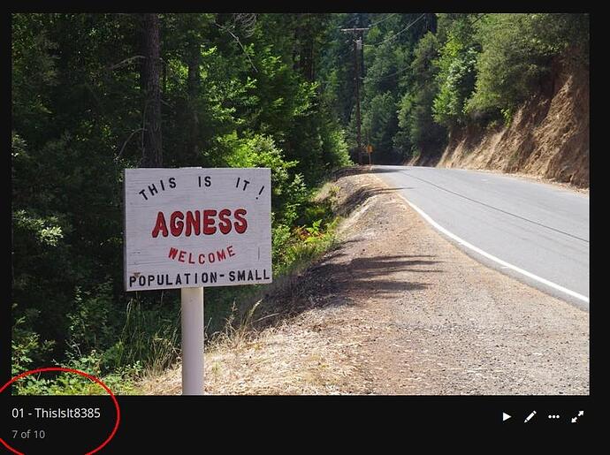

I’ve found several discussions regarding the ordering of photos, but I’ve seen no mention of this particular oddity.
Plex Web seems to display photos in alphanumeric order. But if I open the first photo in a gallery, then hit the ‘next’ arrow, I expect to see the alphanumerically next image. But I usually don’t. I can’t quite discern the pattern Plex Web uses, but it isn’t the same as is used for the thumbnails.
Here is an example:
Filenames:
Gallery thumbnails are correctly displayed in the same order as above:
But open the first image and note the text below - 7 of 10 - clearly wrong:
Plex for Roku Preview seems to have the same problem.
This is fairly serious for photo libraries. It makes it nearly impossible to display slideshows in the order of my choosing.
If this belongs in a different forum, please let me know. I reported it in the Voting forum, hoping that others were seeing it, but I got no responses. I considered moving it to Plex Web, but the Roku Preview app is affected as well.
I have deleted the library, optimized/clean bundles/emptied trash, then recreated the library, but the problem persists. This is affecting most of my photo libraries.
