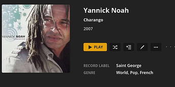

  • Genre Tags under Album show as expected: screenshot

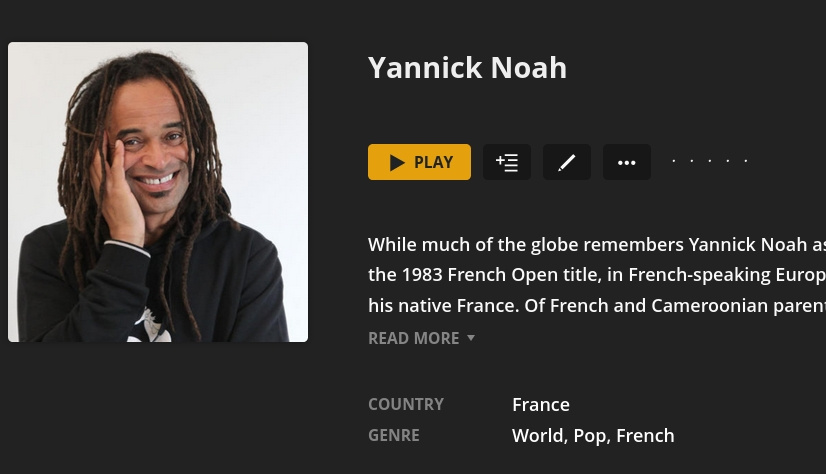

  • Genre Tags under Artists do not honor the “/” separator and show as one big tag: screenshot

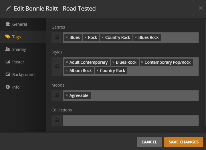

Here’s an example: The album “Road Tested” by Bonnie Raitt. It has four genres picked up by the embedded tags.
The artist Bonnie Raitt has six associated genres, picked up from other albums.
Finally, here’s one with 15 separate genres, all picked up by Plex. That is, nothing been manually edited
