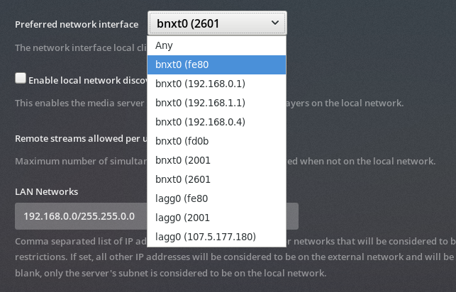

Heh, just noticed that the “Preferred network interface” box has managed to get even worse in this release:
