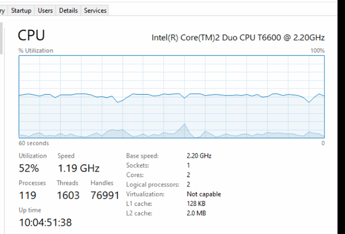

I am running Plex on a Windows 10 64-bit laptop with Intel Core 2 Duo T6600 processor, 4GB RAM. However I have noticed that Plex won’t recognize the 2 cores. It runs on only one core.
Please see the attached screen shots. The Plex Transcoder.exe (32bit) process makes my total cpu usage raise to 50%, while the Plex dashboard shows cpu at 100%.
How can I make Plex itself and Plex Transcoder use the 2 cores?
Right click on the task manager cpu graph, choose change graph to logical processors.
Subtitles and audio transcoding are single threaded and can cap a single core.

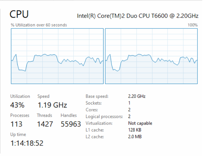

I changed graph to logical processors, see below.
logical%20processors
“Subtitles and audio transcoding are single threaded and can cap a single core.” --> I guess you meant that transcoding will not use of the second core, right?
most video transcoding is multiple core, but subtitles, audio, and VC-1 content is single threaded.
