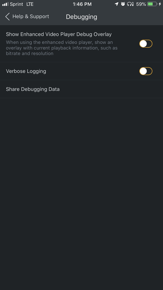

I do not have that toggle.
I currently have
  • show enhanced video player debug overlay’ (which is a crapton of text which you don’t want enabled if you actually want to watch).
  • verbose logging
  • share debugging data
Weird! What version do you have installed?
6.1 (18096) according to testflight
Yes but what version number? :slight_smile:
also, deleting and reinstalling had no effect.
I also removed the previous device authorization before signing back in after reinstalling.
