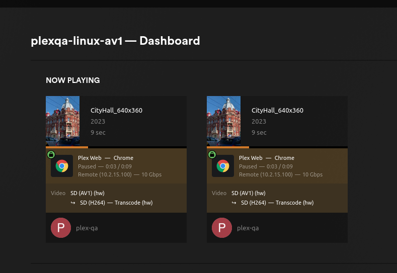

Thanks! I’m very happy to say that this is working like a champ for me.
Using the city hall AV1 file, it plays quickly/easily, and why I check the Plex dashboard i see:
and a quick grab of nvidia-smi while the video is running:
Has me fat, dumb and happy. This card isn’t cheap (today) but it’s going to rock as a transcoder platform for a medium-scale Plex server for me.
Again - my setup is a relatively old Dell R730xd SAS storage server (with 512 GB or RAM and 56 threads on Xeon v4). It’s running truenas scale 22.04 on bare metal, with an Ubuntu 23 VM running Plex on docker.

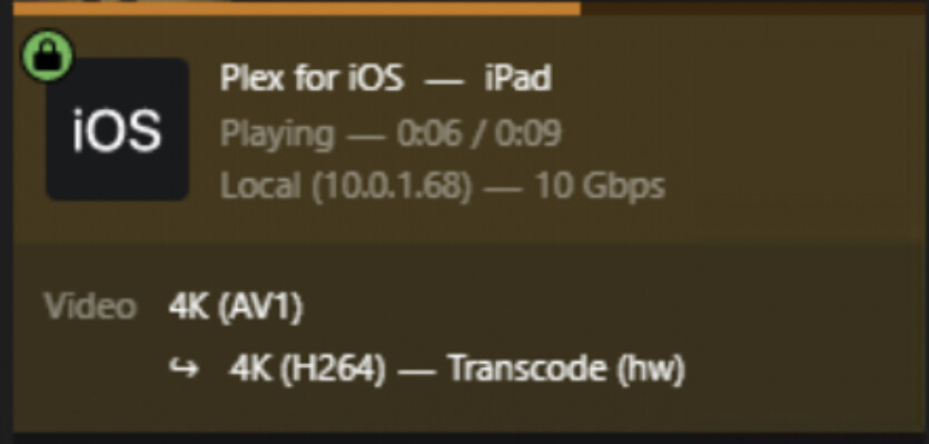

It looks like yours is doing the same as mine by software decoding the file while hardware transcoding it when on paper, both our video cards should be doing 100% of the work instead of 50%.
Gotcha - it’s not hardware decoding - although it is using hardware encoding to pipe the file back out as H264 (to my iPad, which oddly should just be able to take AV1 as-is i believe?).
i could be wrong but i don’t think iOS supports AV1 yet which is a little ridiculous imo…
