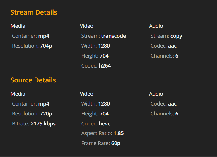

Is plex supposed to transcode everything now?
When I watch from my pc, the stream is being transcoded every time. Any ideas? It shouldnt transcode if it isnt needed. My machine can play the ts video fine without it. I could understand this if I was remote. Am I missing a setting somewhere? I have pretty much scoured them all.

This is a .ts (raw) mpeg 2 file. I could understand this one being transcoded locally.
This is a much lower quality mp4 file and there is no reason at all for a transcode to take place.
So here is the stats from the mp4 convesion. It was converted from HVEC to H264
I do all my conversions in HVEC because I use hardware encoding and it cuts down the time and file size a bunch.
Ok, I just tried IE and it through an error saying that streaming this media type is unsupported. So did something get changed in chrome?

Are you converting from HEVC to H264 or the other way around? Your file shows it is HEVC. It also looks like you are using Plex Web. Browsers can’t handle HEVC video.

My files are in HEVC. My browsers can play them just fine. They always have.
Same with the Roku. It plays them fine as well. No transcoding.
I rolled back to 1.8 something and now they play correctly again.

All of my videos are h.265 and the server is transcoding them to h.264. It worked fine before the new web/player interface in the past release or two. I rolled back to 1.8 something and it works as it did before.

The Plex Web App has never supported HEVC. I don’t know how you are getting it to direct play on PMS 1.8. Can you provide a screenshot of the Now Playing page while playing an HEVC file and it’s XML?
You can get the XML by following this guide. https://support.plex.tv/hc/en-us/articles/201998867-Investigate-Media-Information-and-Formats

I apologize. You are indeed correct that it was transcoding the HEVC files. I perceived it as no transcoding because the playback said (original format) on the settings for the videos I was watching.
