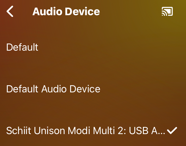

My DAC is also the schiit (always wanted to say that).
SCR-20240605-hmon
If you want to tweak your pi a little so that across reboots it always and only finds your schiit :grinning: I wrote up a little procedure here:
