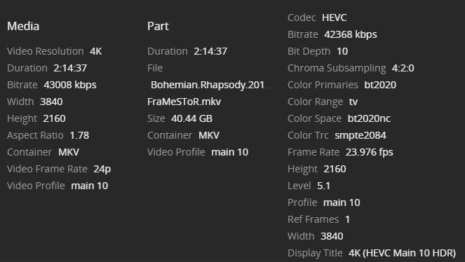

I have many 4k movies that will not transcode. I was originally able to fix this with the method of deleting the easyaudioencoder and having plex re-download this encoder. But the issues persists and is a bit more than frustrating.
When playing this video stream, in my prefered method. is direct and audio is converted to 2 channel.
I do have other files that will play when getting covereted for remote viewing but will not play direct stream or after 5-10 minutes of play back recieve ~your network is not fast enough~ or ~your server is not fast enough~ when either of these are not the problem. My system can real time convert 4k HDR to something else(4790, 24GB ram, large raid6 array) and my server is connected to a nighthawk 10x by ethernet and my shield TV is within 15’ of the router and connects via MIMO AC.

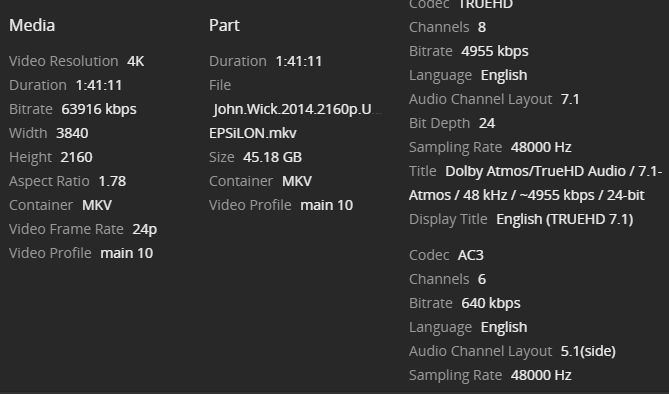

Media info for one of the files I have issues with(this file will not play at all).

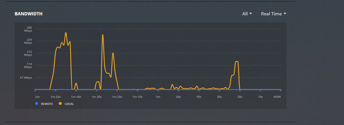

I can see in dashboard(via bandwidth) the plex stops streaming the file out and by htop as cpu load goes back to idle.

John Wick has a lot of audio streams in it. Torrents are like that. I scrolled 5 pages until I got past the list of PMS matching attempts. mkvtoolnix and mkvtoolnix-gui are your friend here. You can discard what you don’t need. It is a pure remux. The quality is unchanged. The benefit to you is faster startup time and less wasted space.
After all this, I just realized something. This is not entirely a server issue.
First, your i7-4790 is incapable of transcoding any HEVC HDR 2160p. It has neither the passmarks nor the QSV support to do so.
This is what places it in the player’s domain. The server must rely on the shield to handle it. To the best of my knowledge (and where I might be 500% wrong) , the Nvidia Shield isn’t going to be able to do that heavy lifting on its own unless it is the PMS server (with its own codecs resident).
The logs above show me the Shield has replied to PMS and the Media Decision Engine (MDE) has printed out what the results were. The ‘decision’ is the player telling PMS what it can do and then PMS deciding what it must do. These results are printed above MDE:
This is where my knowledge of the Shield ends. I know it has capabilities but I am not a Player guy.
