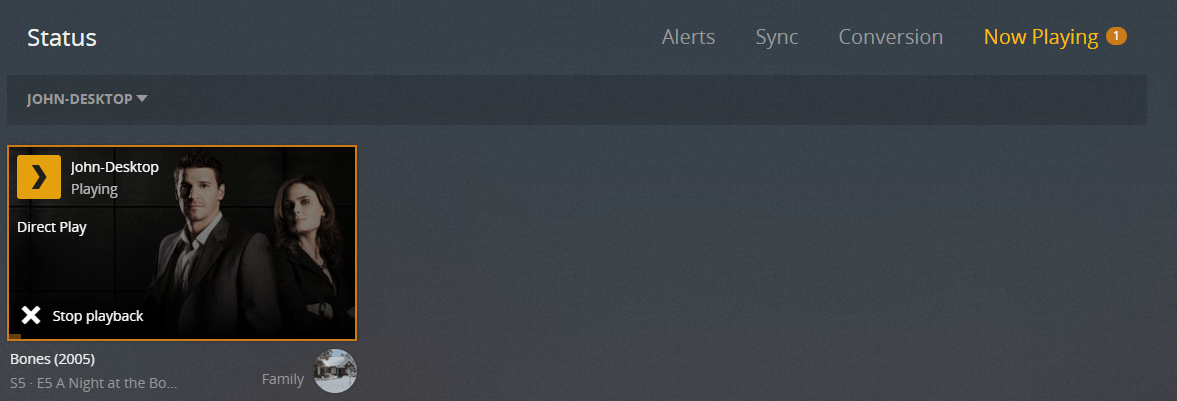

The other media you mentioned playing you said is h264 720p which most if not all clients will have no problems playing so do not need the Plex Media Server to transcode the stream before sending to the client. In the server it would show Direct Play if you looked at the Status screen in Plex Media Server.
Live TV on the other hand is received by the Plex Media Server as a mpeg stream from the tuner that the client more than likely can not handle directly so the stream must be transcoded before sending to the client. Which is why you are seeing high CPU utilization on the server. Whether transcoding or not depends on the client, as you can see from the image below my Fire TV stick does not require transcoding apparently as it is able to direct play Live TV.

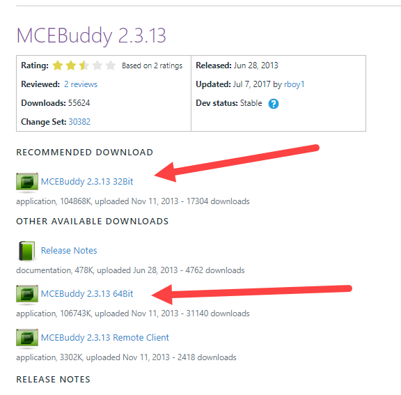

Adding this note for anyone who comes across this thread… make sure you follow the direct link to MCEBuddy provided by @johnm_ColaSC above. If you go to the main MCEBuddy page on codeplex, there is a big purple download button that downloads an rtf pointing you to the main site for the paid version.
johnm’s link above takes you directly to the right version… see his note below.

@qwurpy the free version is still on the site at the link I provided.
@johnm_ColaSC
Ah!!! Thanks. And that’s my bad for not following the exact link. I actually had this thread on one machine and manually typed in the main URL on the other machine (the server). The big purple “download” button on the overview tab is what downloads the rtf.
Thank you for pointing this out!! I’ll revise my previous post.
