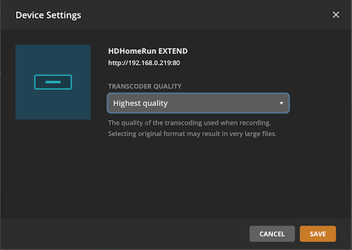

Your Extend settings look good. I have one too. Turn off the “Use Hardware Acceleration when Available” on the transcoder page. Save changes. Reboot.
On the DVR device setting in Plex, set the Transcoder Quality to Original format. Reboot.

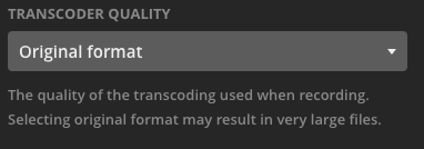

So I changed the settings as advised and rebooted the Mac and voila. Plex is playing live TV from all devices. I will tinker with the settings, ensuring to reboot after changing each.
The only constant setting that works is
Settings → Live TV & DVR → Device Settings → TRANSCODER QUALITY → Original format
Does not matter if this setting is enabled or disabled
_Settings → Transcoder → Use hardware acceleration when available
Makes me wonder. Since the HDHomeRun EXTEND has hardware transcoding, is it necessary to enable Settings -> Transcoder -> Use hardware acceleration when available ?

TEST 1
Settings:
Settings → Transcoder → Use hardware acceleration when available → Enabled
Settings → Live TV & DVR → Device Settings → TRANSCODER QUALITY → Highest quality
Result: Plex does not play video (reference screen shots above). Audio only.
TEST 2
Settings:
Settings → Transcoder → Use hardware acceleration when available → Disabled
TEST 3
Settings:
Settings → Live TV & DVR → Device Settings → TRANSCODER QUALITY → High quality (30fps limit)
TEST 4
Settings:
TEST 5
Settings:
Settings → Live TV & DVR → Device Settings → TRANSCODER QUALITY → Medium quality (540p)
TEST 6
Settings:

From my perspective, the transcode setting in Settings -> Live TV & DVR -> Device Settings -> TRANSCODER QUALITY -> Original format is a Plex software setting (“The quality of the transcoding used when recording. Selecting original format may result in very large files.”).
That is, I think the HdHomeRun EXTEND sends the same quality and that you cannot change the transcode output of the unit. This would seem to make sense since I was always able to play live TV from VLC or from the HDHomeRun application.
This seems like a Plex software issue.
@plexPass12345 said:
TEST 1
Settings:
FYI, this is the settings set that I use, and everything works fine for me. I believe logged into the Extend, I also have that set one notch below the equivalent of “Original Quality” which enables the transcoder in the Extend. However, If I’m not mistaken, whatever you set in Plex is not complimentary, but rather overrides what is set in the Extend. (I may get corrected there)
Long story short, there has to be something else going on, because this works for me.

Thanks. Would you mind sharing your EXTEND and Plex settings? My assumption is that the EXTEND settings should be set to the same or equivalent in the Plex settings. One thing to keep in mind is that from my understanding, the options at Settings -> Live TV & DVR -> Device Settings -> TRANSCODER QUALITY -> only apply to recording, not to viewing. I am basing this off of the caption in Plex itself:
Here are the options for the EXTEND:
Here are the options for Plex transcoding (for recording, not for viewing):

The Extend’s internal transcoder is also used to watch LiveTV. Most devices don’t support the native mpegts container and mpeg2 video codec used so it needs to be transcoded to h264. It you set the Extend to original, then Plex’s transcoder will do that job, if you have anything else, then the Extend’s transcoder will do it. From what you describe, either your Extend has a flaw and the transcoder isn’t working correctly, or the Extend’s transcoder cannot handle your TV signal for some reason.

HDHomeRun
The default transcode profile is set to: Heavy
Plex
Transcoder Quality: Highest Quality
Happy to let you know any other setting I have if it helps. I have two Extends set in this configuration.

Plex does not play live TV with these settings. Attached is what I see. As with other tests, I hear audio. Log files are also attached.

Please note, Plex will not play live TV on either HD or SD unless Plex is set to the following (HDHomeRun Default Transcode Profile setting does not matter):
@“MovieFan.Plex” said:
Have you tried scheduling a recording and seeing if that works?
Scheduled recording works fine so long as Plex is set to
