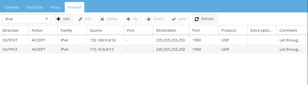

Yep found it.
So @antoine_raynard_plex_pm_me you need to add 2 rules
Go to network>firewall
New rule > accept output , source IP 192.168.0.0/16 (LAN ips) and 2nd
172.16.0.0/12 (docker lan ips) to destination ip 239.255.255.250 and port 1900 UDP
Thats it. Thanks @pshanew

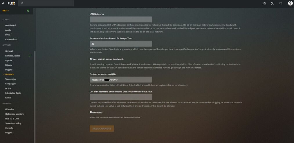

In my case, these 2 rules solved the issue for good.
Clipboard01
I applied the rules you suggested, the problem stopped for about 45 before starting again.
I looks like it doesn’t matter what Firewall rule I apply, it will stop the warning for some time before starting again to flood the log…

I only have only these 2 rules in my OMV firewall:
From my host, the IP table looks like this, no idea if there is something wrong showing (my knowledge of networking doesn’t go beyond IP, masks and MAC address):
