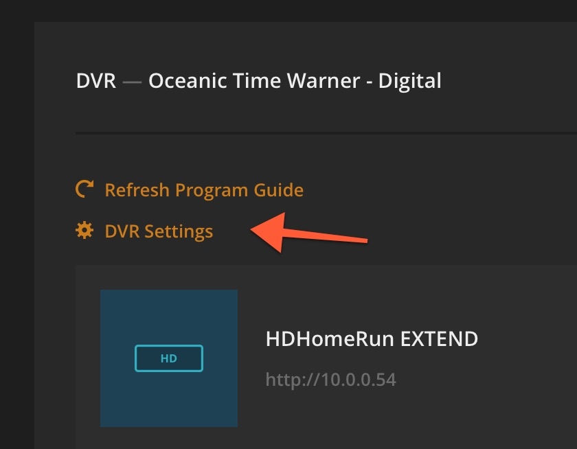

Have you been able to find the post processing in the GUI?
Look in DVR settings, you may need to scroll down.
Just found it. Clearly I wasn’t looking hard enough :stuck_out_tongue:
