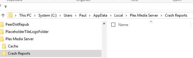

It did not appear to create a crash report for uploading.

Have a look at %LocalAppData%\CrashDumps
There currently is no files in that directory:
