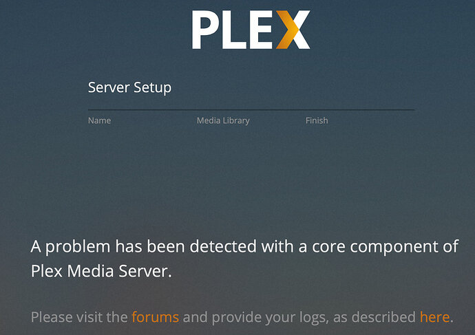

It sticks like this, never fully starting…

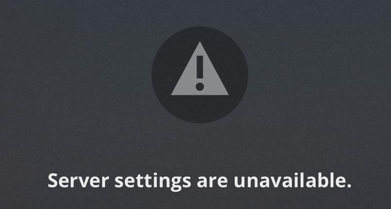

All server setting just give me this…
New content can’t be loaded in. Movie posters and info seems to be disappearing more and more.

I removed Plex completely. Rebooted. Installed it again, and relaunched… still not working. I’ve attached the logs here.
Plex Media (34.4 KB)
Here is what shows in the WebUI now on the fresh install.
SOVLED
To get a lot of the metadata off my primary drive I was using a symlink, which had worked fine for many month, and I saw a lot of people using it without issue online. I removed that and migrated the Application Support data back to my primary drive. This got Plex to start.
Once it started, my libraries were not loading properly. I re-scanned and optimized the database, quit and restarted Plex, and it started working.
