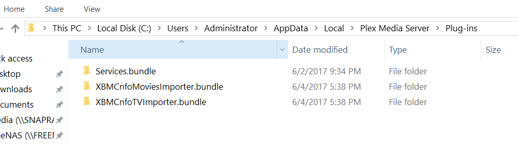

My Plex Server is on the Windows machine, I have added both the files to the said Plugin’s folder. The option to find and choose the plugin folders is integrated with the Plex Server in the tray icon. I also performed a shutdown and restart of the plex server.
Please see below…
Where do i see the plex agent showing up? Did it show up? Please see below.
How do i generate a new Library as mentioned in your previous post. I’ve rescanned/updated the libary, but still do not see any new updates of movies in the libary. I guess i am missing a step as seen in the above screenshots?
My apologies for the dumb question, thousands of folks here made this work, looks like i am the only one who;s having trouble here to grasp this whole thing.
@monukoshy : The Agents are not showing on your system. If you rebooted plex, you installed them to the wrong Plug-ins folder. Are you really running as Administrator? Please check the other users, too.
