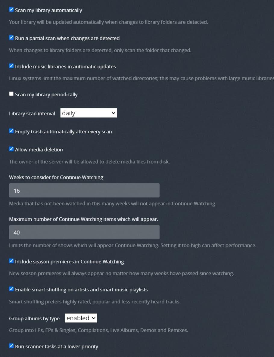

So far no issues after removing the old path so that is great. For some reason though, it does not detect new files added to the new NAS unless I manually run a library scan.
The option to “scan my library automatically” IS supposed to work on Ubuntu right? It was working fine on the old Plex install on the Synology. I turned off “scan my library periodically” but that didn’t seem to make any difference.
Rebooted the NUC as well.
“Automatically detect changes” does not work across network mounts.
Neither NFS nor SMB support notifying a client mount of server-side changes
The Linux kernel notification service can only detect changes for those files directly under its control.
If the server is running on Synology, and files are changes on the Syno, it will detect that. The same is true of the Ubuntu Linux host.
Good to know! So I guess I’ll just turn on the “scan periodically” option. I’ll just have it run hourly instead of daily.

I have to do the same for my NUC.
I’ve configured it to:
  1. Periodic - every 15
  2. Partial Scan - enabled
This makes it run as quickly as possible.
If 15 minutes works for you, then I’ll do the same :slight_smile:
