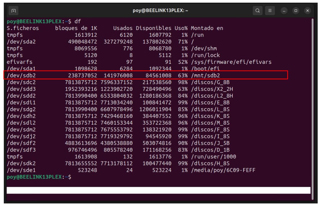

Which path did you use to mount the original SSD ?
Did you mount it as /mnt ?
What I’m looking for is where the original /var/lib directory is now located
Once I know the path, I’ll help you with the commands to use
@PoyPoy
the df command should give enough information about where the SSD is currently mounted.
oopps … same configuration for both (old and new one): /var/lib on root … no external drives for installations/installed files
/var/lib/plexmediaserver/ …
I understand the configuration will be the same — BUT ----
The old SSD will have a var/lib on it.
When you mount that SSD, it will mount as something like
sudo bash
mount -o ro /dev/sdxx /mnt
When you do this, you’ll see a /mnt/var/lib/plexmediaserver
This is what I’m looking for. Where is the original PMS directory you want to migrate from ?
understood… you wanna know where the original SSD has been mounted in current machine. It’s /dev/sdb2
Yes please
Which directory is it mounted on?
Look at my machine.
The /dev (device) entries are in the left column and the mount directories are in the right column (mount path). Knowing the device node doesn’t help at this point.
I need to know that mount path

… and Mount directory is /mnt/sdb2
Thanks.
