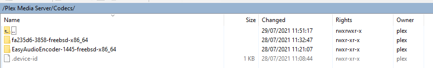

Thanks for your reply I followed your instructions:
1. Stopped Plex
service plexmediaserver stop
2. Codecs Directory
3. Deleted files except .device_id
Deleted the top two files in the Codecs directory
Started PMS
service plexmediaserver start
I checked and the files were re-downloaded after I started playback, after several minutes the problem persisted.
