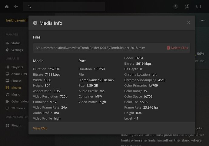

Lately I’ve been re-ripping any movies I find in my library that are 720p to 1080p and recently came across one that is causing me an issue. In Plex it showed 720p so I ripped it again and transcoded it in Handbrake with one of my HiQ presets. Copied it to the server and refreshed and… it’s still showing as 720p. I did it again thinking I screwed something up and same thing.
Here’s a screen grab of the file info.
Can anyone explain why this is happening and more to the point, how to fix the data? If I can rely on what I see in Plex it’s going be a bit more of a chore to find files I need to update.

1080p is 1920 x 1080 so if it’s anything less I think is gonna register as the next level down. For example I use handbrake to rip DVDs which are all 480p. Some show as 480p and some as SD depending on the resolution.
Yeah, I get that, but the sleeve says 1080p, I’m ripping full out of MakeMKV, then I let handbrake auto trim as always but at full size how the hell is it ending up like this? I’ve tried 3 times and they all have end up this size. Anybody else out there with Tomb Raider 2018 Blu Ray, non 4K, and can have a look?
If this is indeed the file and not Plex, I humbly apologize. I just don’t understand what’s happening when I do the same procedure with every rip.
What’s the MKV actual resolution?
Normally Handbrake wouldn’t trim the sides of a modern movie. Is the movie being shown from edge-to-edge, horizontally, when you watch the original? If so, Handbrake is making an error on auto-cropping. Because it’s cropping the width from 1920 to 1856. Which is really weird on any modern mainstream movie.

I’ve the same movie and it shows the same as what you have.
Look at the Width & Height, 1856 x 804, not what Plex shows for the resolution. Something with that width & height is obviously not 720p.
I have other Blu-ray 1080p movies that show as 720p and DVD movies that show as SD, not 480p. It does not affect playback, so I tend to consider it a non-issue.

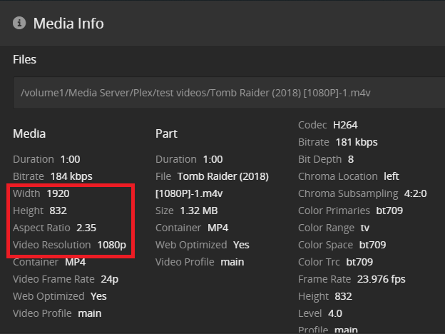

WRT Handbrake, you can change the cropping from Auto to Custom and all zeros. This will give you a 1920x1080 picture with the correct aspect ratio. However, it will include the black bars on top & bottom in addition to what Handbrake chooses to crop from the sides.
Here’s another alternative, which gives you 1920 width w/o encoding the full top & bottom black bars and keeps the correct aspect ratio (I’m using the Super HQ 1080p30 Surround preset and Tomb Raider (2018) movie):
  1. Load the MakeMKV Blu-ray rip into Handbrake.
  2. On Dimensions Tab, note Display Size 1856 x 804, PAR 1x1, Top & Bottom cropping = 138. Left=14, Right=50.
  3. On Dimensions Tab, change Anamorphic from Automatic to None.
  4. Note Display Size is now 1920 x 832, PAR 1x1
  5. Change Cropping to Custom, and Left & Right to Zero.
  6. Decrease Top & Bottom by equal amounts until Display Size = 1920x832, PAR=1x1. For this example Top & Bottom are both 124.
  7. Set other tabs as desired & encode the movie.
To double check the math: (832-804) = 28 = [(138-124) + (138-124)]. Also, (1920-1856) = 64 = (14+50).
There’s probably another way, with less steps, to force the width to 1920, but the above works for me.
MediaInfo using above method. Ignore duration & bitrate. I encoded 1 minute with preset = UltraFast as test.
