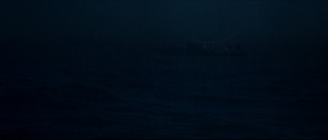

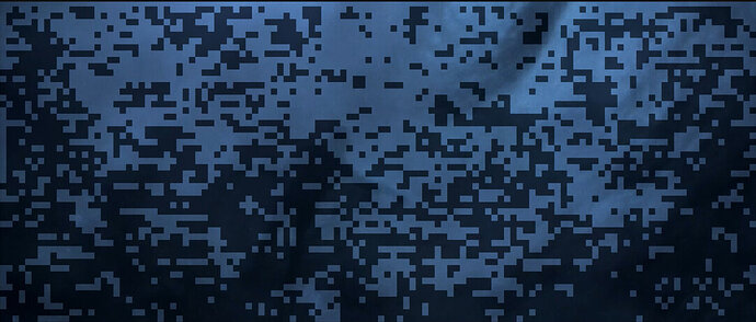

This problem is present since ages.
Example:
This happens only in dark / flashing scenes and not in all frames:
It happens only if I hardware-transcode through my Intel iGPU (UHD 630 / UHD P630) and not if I use software-transcoding. I was not able to test it with an Nvidia GPU, but I think its only related to Intel.

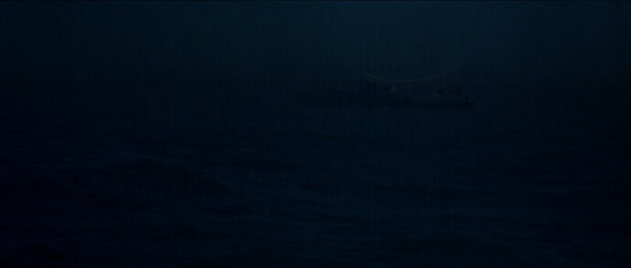

I transcoded the sample file with the following ffmpeg container and the output is flawless:
docker run --device /dev/dri:/dev/dri -v $(pwd):$(pwd) -w $(pwd) jrottenberg/ffmpeg:vaapi -y -hwaccel vaapi -hwaccel_output_format vaapi -i input.mkv -vcodec vc1_vaapi -acodec copy -b:v 10000K -c:v h264_vaapi output.mp4
Result:
https://www.dropbox.com/s/umiy7na2d6kxv4a/2021-04-09%2015-44-07.mkv?dl=0

This is what was inside the Plex transcoding dir:
https://www.dropbox.com/s/ftsiqvsu8u0fsi6/chunk6.mkv?dl=0
(I used “cat” to create the video file with the “header” and “chunk-xxx” file)

The problem is there is a bug in Intel’s drivers on Linux when it comes to VC-1 hardware decoding. This was fixed at one point years ago but then Intel put out a new driver re-breaking it. The problem is the new driver is necessary (I don’t recall the details but likely due to hardware support) so we can’t go back.
The same issue doesn’t exist on Windows. Given the persistence of this, either Intel doesn’t care about VC-1 or Linux (or both).
