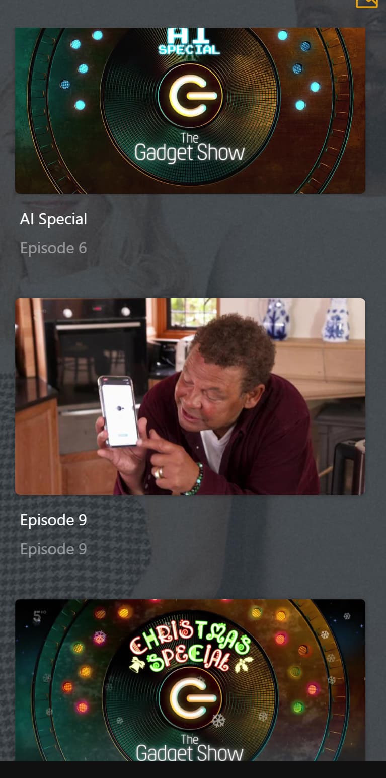

Well, I honestly don’t know what to say about this!..
I am meticulous about my poster art, and in fact here is an example of 2 custom posters that don’t exist beside the file, and yet they are still there in Plex, selected…
