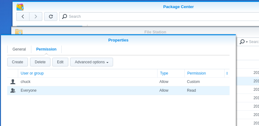

You’ll also want to correct these filesystem permissions so Plex can read the files (use FileStation to gr ant Read). If permissions already allow reading, then I know what’s happening. You’ve exceeded the kernel’s default iNotify table size of 8192 directories. Do you have more than 8192 directories?
Sep 22, 2018 14:31:29.779 [0x7f40e311d0] ERROR - [Notify] Failed to add watch for /volume1/video/Anderes (13: Permission denied)
Sep 22, 2018 14:31:29.778 [0x7f8aab81d0] DEBUG - [Notify] Waiting for inotify notifications...
Sep 22, 2018 14:31:31.006 [0x7f40e311d0] ERROR - [Notify] Failed to add watch for /volume1/video/Serien (13: Permission denied)
Sep 22, 2018 14:31:31.624 [0x7f40e311d0] ERROR - [Notify] Failed to add watch for /volume1/video/Serien/Hawaii Five-0 (13: Permission denied)
Sep 22, 2018 14:31:31.624 [0x7f40e311d0] ERROR - [Notify] Failed to add watch for /volume1/video/Serien/Hawaii Five-0/Season 3 (13: Permission denied)
I suggest you go to the top-level directory, right click it,
Properties -> Permissions tab -> Apply to this folder, sub-folders, and files.

Regarding the filesystem problems Plex at installation has notified me because of this. Then I did what you with the permissions and with applying it to subfolders.

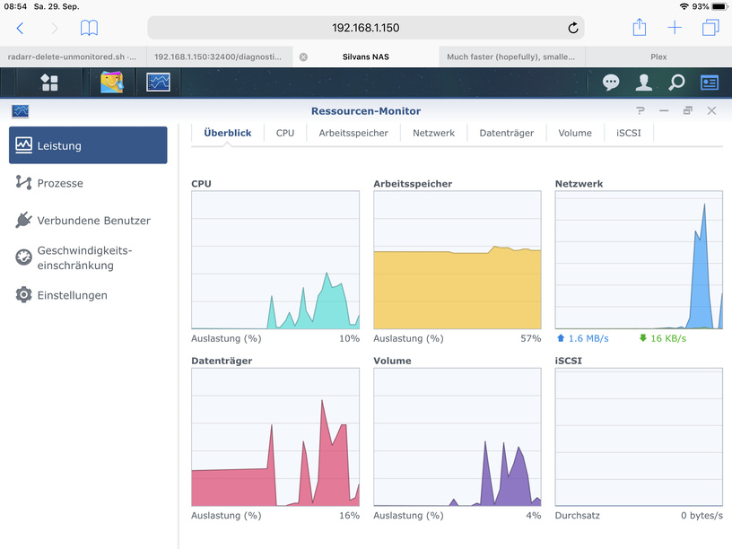

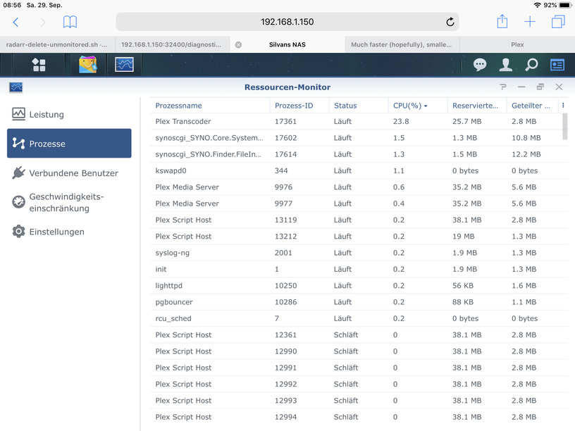

I also took a screenshot of the realtime cpu statistics as you suggested, they were made while watching a movie 1080p DirectStream with audio transcoding from AC3 to AAC.

Screenshot of Resource Monitor:

Your resource monitor screenshot was after all this - would have been interesting to see what it was at 08:23 am / 08:24 am

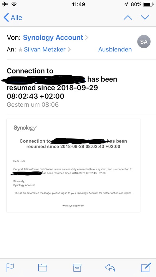

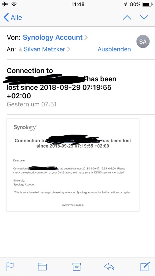

The server was restarted at 08:26:46
The problem is, that you can‘t really know when the crash will happen, it happens sometimes usually a couple of hours after restart. The only message I get is a mail from Synology stating that my Synology lost connection to the internet because the NAS also acts as a DynDNS updater.

That sounds like you’re “swapping its brains out” when DS Finder (a core DSM application using 8 MB in DSM) stops responding to network queries
Running PMS (500 MB),
VPN (50 MB ?)
SABnzb (32 MB ?) when not processing anything,
Is already a heavy commitment on memory.
The key to diagnosis here is watching the disk LED. If it’s flicking, then everything is running and there is no alternative but to wait.
After it does return, you really have no choice but to start limiting the activity for now until PMS memory requirements (production form) drop.
