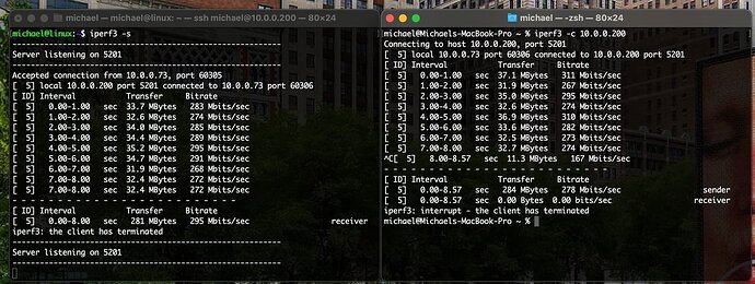

Have you tried running iperf3 between the server and the pc with the issue, just to rule out a network issue as that’s a better test than internet speed. This is from my Mac to my Ubuntu server over Wifi and 4K remuxes work fine (at least with Infuse)
Hi Yesternow,
Thank you for the response. I just downloaded iPerf 3.1.3 for Windows and tried to run it. Does this application have any sort of GUI? I only see a command prompt window flash for a second with no GUI appearing.
Not that I’m aware of no, just run a command prompt on Windows: iperf3 -c UnraidServerIP and ssh to Unraid and run iperf3 -s.
I’ve never used Unraid only standard Linux so not sure if iperf3 is installed by default or not.

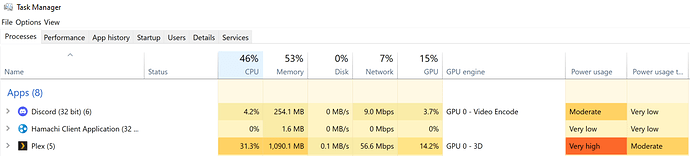

That’s some good diagnostic work there. I’m not super familiar with the desktop clients so I cant really provide any help there. The only potential issues I can see off the top of my head is that the gtx970 and p2000 don’t support nvenc decoding of 4k hdr content. At least from what I remember, but considering the 1660ti is also having issues it leads me to believe there may be an issue with the actual software. I would be curious to see the cpu/gpu utilizations. Specifically decoding usage on the gpus and also cpu usage+number of threads being used.
The 9700K/P2000 is the only PC that I can successfully direct play these 4K HEVC files so if it isn’t using the GPU to decode then I’m assuming the CPU is doing it. I just did some testing with the i7-4770/GTX 970 PC. I used the Plex desktop client to download one of the 4K HEVC movies to the client PC for local play, then shut off my Plex server to ensure that any streaming content is off. The same content that buffers horribly when streaming from my server plays smoothly with no repeated buffering when played locally! Here is a screenshot of the CPU/GPU usage on the i7-4770/GTX 970 PC when playing the 4K HEVC file locally:
There was a long initial period of buffering that occurred before the file played locally but after that the playback was perfect, Plex is even doing the HDR to SDR mapping correctly as this content is being played on a monitor that does not support HDR.
For comparison here is the same file streaming from my server (network is no longer zero):
This confirms that the 4K HEVC content can be natively played by this hardware. The issue has to be with Plex or something with the network that we don’t yet understand.
