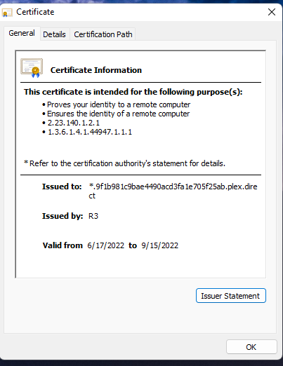

My site certificate is fine but plex says I'm not secure
Server Version#: DSM 6.2.4-25556 Update 6
Player Version#: Current (updated today after the issue appeared)
My web cert is secure when I go to the normal web site URL, but Plex seems to have exploded.
If I connect to the plex it can’t connect but the site https:mysite.com::32400/web give me the error below.
All I get is:
our connection is not private
Attackers might be trying to steal your information from XXX.com (for example, passwords, messages, or credit cards). Learn more
NET::ERR_CERT_COMMON_NAME_INVALID
Any help would be appreciated.

Adding to that, Plex is serving the local SSL cert (plex.direkt)
download logs, and check the first 100 lines of Plex Media Server.log for any cert info. I’m guessing Plex can’t read your cert and just doesn’t apply it.
