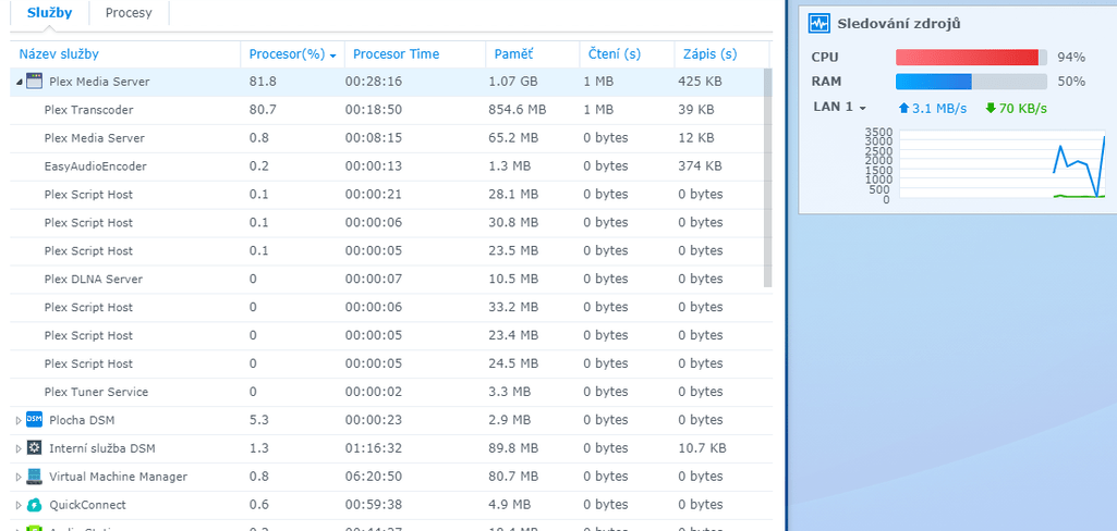

Hi, i have problem during watching 4K mkv video on my Samsung TV UE55MU7002 locally. Everything is wired with 1Gbit Lan, everything up to date. I don’t have plex pass but locally on 4K TV it doesn’t require it if i am correct. Cpu reachs almost 100%, video buffer each 4 second and is unwachable.
DS918+ should stream such a movie without any problems, especially locally. Maybe i misconfigured something wrongly.

Thanks for the logs.
  1. I confirm it is transcoding.
  2. It is transcoding because the application has a 20 Mbps limit applied (check that in the settings?)
  3. As stated above, without a PlexPass, the CPU will be charged to do the work.
  4. At 32 Mbps input, transcoding down to 20 Mbps, is impossible for that CPU to perform in real-time. It will surge terribly.

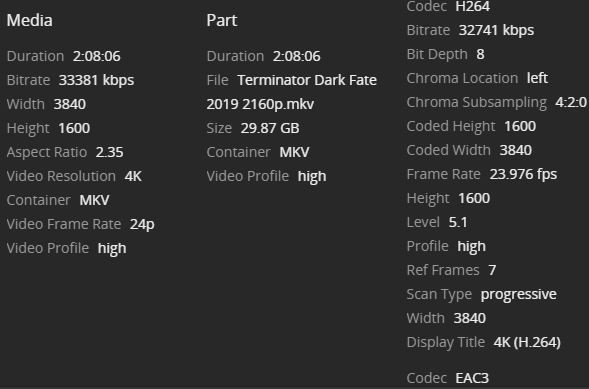

Transcoded movie xml
<Media id="14" duration="7686208" bitrate="33381" width="3840" height="1600" aspectRatio="2.35" audioChannels="6" audioCodec="eac3" videoCodec="h264" videoResolution="4k" container="mkv" videoFrameRate="24p" videoProfile="high">
<Part accessible="1" exists="1" id="790" key="/library/parts/790/1579644573/file.mkv" duration="7686208" file="/volume1/video/Filmy 4K/Terminator Dark Fate 2019 2160p/Terminator Dark Fate 2019 2160p.mkv" size="32073967827" container="mkv" deepAnalysisVersion="4" requiredBandwidths="89669,83008,69157,51518,50100,50100,50100,50100" videoProfile="high">
<Stream id="3227" streamType="1" default="1" codec="h264" index="0" bitrate="32741" bitDepth="8" chromaLocation="left" chromaSubsampling="4:2:0" codedHeight="1600" codedWidth="3840" frameRate="23.976" hasScalingMatrix="0" height="1600" level="51" profile="high" refFrames="7" requiredBandwidths="89027,82369,68516,50878,49494,49494,49494,49494" scanType="progressive" width="3840" displayTitle="4K (H.264)"/>
<Stream id="3228" streamType="2" selected="1" default="1" codec="eac3" index="1" channels="6" bitrate="640" language="English" languageCode="eng" audioChannelLayout="5.1(side)" requiredBandwidths="640,640,640,640,640,640,640,640" samplingRate="48000" displayTitle="English (EAC3 5.1)"/>
<Stream id="3229" streamType="3" codec="srt" index="2" bitrate="0" language="English" languageCode="eng" requiredBandwidths="1,1,1,1,1,1,1,1" displayTitle="English (SRT)"/>
<Stream id="3230" streamType="3" codec="srt" index="3" bitrate="0" language="English" languageCode="eng" requiredBandwidths="1,1,1,1,1,1,1,1" title="SDH" displayTitle="English (SRT)"/>
<Stream id="4965" key="/library/streams/4965" streamType="3" codec="srt" format="srt" displayTitle="Unknown (SRT External)"/>
</Part>
</Media>
Thank you.
As I suspected, the H.264 title is not encoded correctly.
  1. Reference Frames > 5 (it has 7)
  2. Video Profile = “High” ( Profile 4.0 = 20 Mbps maximum)
PMS is seeing the excessive reference frames and transcoding. It’s using the given Video Profile (“High”) to encode to 20 Mbps.
The DirectPlay video is “main 10” (which is video profile 5.1 or 5.2 at up to 150 Mbps) but does not have more than 5 reference frame encoding and can therefore DirectPlay.
