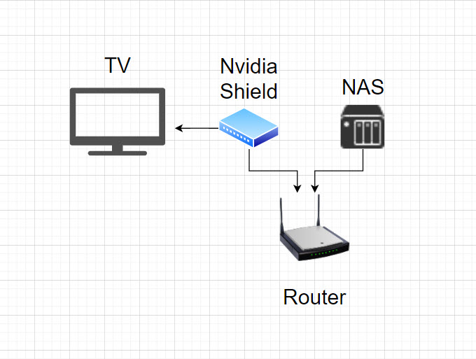

I sorry for all of the questions. I would need to purchase some kind of storage (NAS0 but not use the CPU. and then the Nvidia shield would run PMS ? Stream to one TV? I’m just not familiar with the Nvidia Shield. If you wouldn’t mind, would you please type out a basic flow chart for me ? storage to Nvidia running Plex and then to one TV ? or then to my network ? Thanks again.

Blockquote If you wouldn’t mind, would you please type out a basic flow chart for me ? storage to Nvidia running Plex and then to one TV ? or then to my network ?
Sure, here’s a quick rough diagram of the system:
https://imgur.com/a/F6UTlTf
Plex_plan
