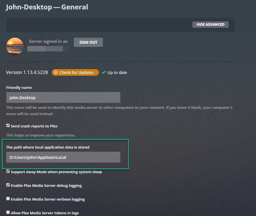

Why would the Plex Server Files take nearly 60Gb?
Can I move this to another drive? I don’t like having metadata which is written every day burning the life out of my SSD NAND.
Thanks.
Settings / Server change the location where local appdata is stored. From what I recall you should copy the data manually. Then change the location.
@johnm_ColaSC
Thank you for that information. I will continue to pursue moving my server to the other machine per the instructions above.
