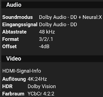

I think there might be an issue with films that have Dolby Atmos/TruHD soundtracks and DV (A Star is Born and Top Gun). I can only get sound out from these or standard HDR with the TruHD transcoded to DD+.
I don’t see the same issue with DTS soundtracks (Gladiator, DTS:X; Universal Soldier, DTS HD-MA).

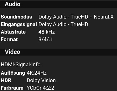

The good news is that everything works so far. Auto frame rate switching, 24hz, 60hz, all DTS and Dolby tracks, subtitles and chapters :star_struck: :partying_face: :sunglasses:
atmos24 atmos60 true dd dtshd dtsx
… I will of course test everything in detail one by one. my first look is good.
