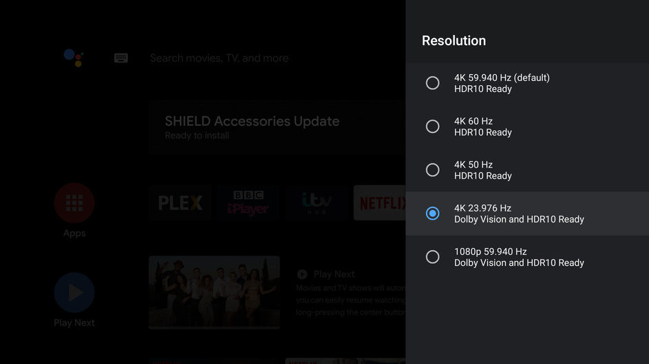

Can you confirm inside of the Android Settings that the mode is correct, the resolution needs to be in a mode that supports Dolby Vision and HDR10;

The three files were tested both on the same setting in your screenshot and at 4K 59.940 Hz, definitely with both “Dolby Vision and HDR10 Ready” enabled.

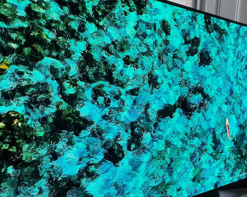

Here’s an LG Dolby Vision sample that is single layer and uses MPEGTS as a container, if you could give this a try and let me know how it plays that would be great. https://drive.google.com/file/d/1kKRoJEgsDeE59Nbuy8A1DsSvc3eBac08/view?usp=sharing
With this video, an easy way to tell if it’s Dolby Vision will be when the sea scene comes on with the boat (10 seconds into the video), without Dolby Vision the sea will be green, with Dolby Vision it will be blue.
Without Dolby Vision:
With Dolby Vision:
Definitely green sea and not blue. :grinning:
