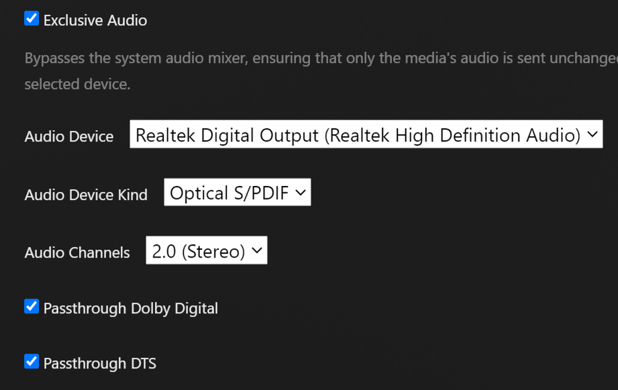

With the above settings, regular DTS and AC3 are bitstreamed over your toslink connection. i.e. the audio data are not changed in any way. While doing this, the volume slider of the player has no effect.
All the other audio formats however need to be decoded by the player to PCM stereo. This is where the volume slider of the player also becomes effective again.
Wiggle your mouse pointer over the picture during playback. The volume slider is at the bottom right of the player bar. See that it’s not muted or lowered to zero.

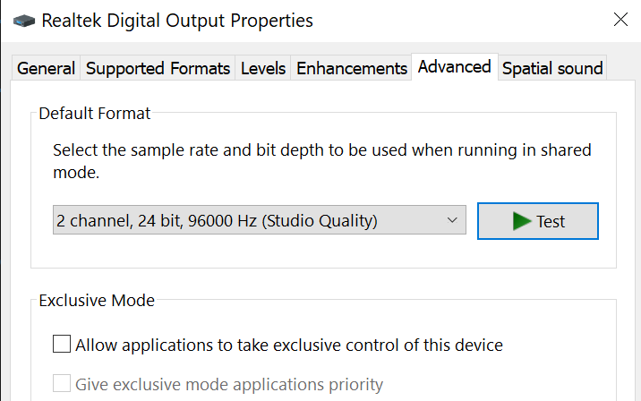

  • Locking the audio software: Did you mean hardware? I’ve tried both settings actually - no change in behaviour:
Right now exclusive control is not enabled.
You mean usable to Plex? it will bit stream to it no problem - obviously it sees the hardware.

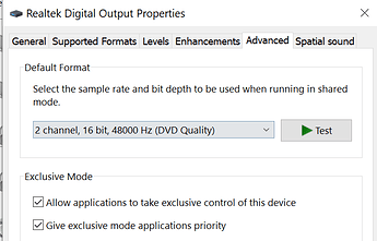

Try setting that to 48 kHz sample rate, 16 bit.
Yea - I tried 16/48 and 16/44.1. No joy.
Anyway - that’s just a default and this should be set by the app.
The original TOSlink specification only knew maximum 48 kHz at maximum 20 bit resolution. You should set the default this or below this. Because not all apps are telling the audio output which parameters to switch to.
This is not ASIO or similar.
Yup its normally set to 16/48. I’ve been trying different settings to wake something up.

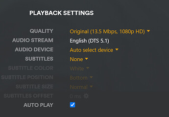

When I set the playback settings to the Realtek Digital Output - nothing happens. Video won’t start. When I change the audio device to “auto select device” it plays in stereo - instead of bit streaming the DTS 5.1 to the AVR. Why? It is still using the toslink output… it clear Plex knows that there is a DTS 5.1 stream… but it downgrades to stereo PCM - my Pioneer AVR says so:
when I try to change it back to the specific audio device… audio is muted… or if the video is stopped, it won’t even start.

You might wanna try enabling “Allow applications to take exclusive control of this device”
or disable the equivalent option in the Plex app to use “exclusive mode”
I tried that earlier - and just changed my system to do this again …and no-go.
Do I need to restart when I make these changes in Plex?
I also tried this:
Still no audio playback.

Setting are currently this:
Still no playback.
