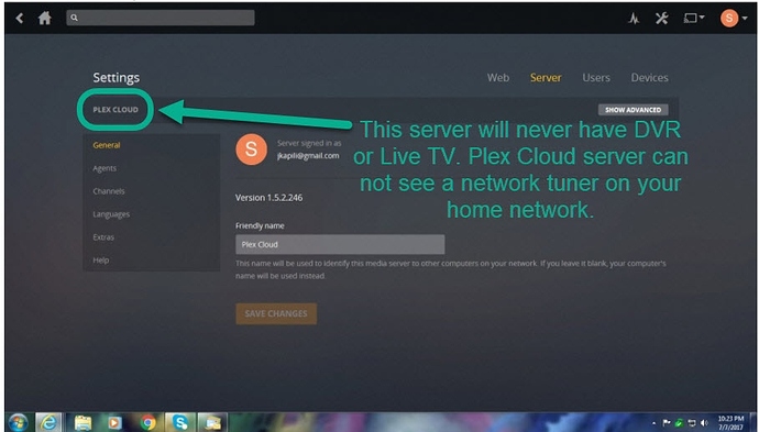

Thanks for the input. I’m not trying to use the server for live tv. When I use the plex app the instructions say go to settings then server and a dvr to scan tuner for channels. I have no dvr option to scan for channels.
This is my screen
First if that is a physical server in your house you are trying to configure you need to update to current Plex version. Version 1.2.0??? Current Plex version that will support Live TV on your physical server is 1.7.5. As previously mentioned Plex Cloud will not be able to see your tuner device on your home network.
The screen shots above are from my desktop logged into plex .tv.com from browser. The screen looks the same from Vizio Smart Tv Plex app, Android Plex app, Linux browser Plex.tv, or Kodi Plex addon, I have no DVR option to scan for Live TV for any tuner. OTA Cable or Internet.

As previously stated Plex Cloud will does not have Live TV. Not matter what client you try to view the Ple Cloud server on you will not find Live TV or DVR.

As you have seen from the video it states starting at the 30 second mark that it works with indoor or outdoor antennas, and shows supported tuner devices immediately after the antennas. Then at the 45 second mark it shows their server installed on their network called Plex DVR, not Plex Cloud, and shows adding the tuner device from the DVR settings.
So you must have:
  1. Antenna (OTA) or Cable TV Service
  2. Supported tuner device for the type of service you are using OTA or Cable
  3. Plex Server installed on a computer, NAS, or other supported hardware on your home network.
