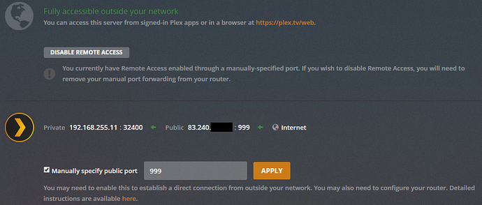

The whole problem:
But my devices connect from WAN. However I remember having my server couple times “offline” while I was sure there was no connectivity issue.
My Router: Ubiquity EdgeRouter PoE v1.10.8 (upgraded to latest image)
At the time I wrote this topic I did not have UPnP set up at my router. After suggesting it I enabled it via GUI - no change. Recently I started having complains from my sister in different city that Plex is unreachable from time to time… I didnt notice because I access it 95% of a time from LAN. So I started playing with the network setup.
My default configuration is so called static port forwarding. Which works for all my services except plex.
  1. Static portforwarding (999->32400): with or without Hairpin NAT (NAT loopback or NAT reflection)

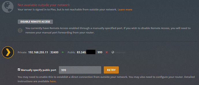

None of the above fixed the “Remote Access” problem, neither DLNA on LAN…
Every time I did a configuration change on the network I restarted the docker container for plex service, then tried to re-enable remote access again. And the results is, that for like 2-3 seconds it blinks green " Fully accessible outside your network"
but right after that it goes again:
I am really clueless now and desperate to fix it :confused: Anyway attaching again my logs.

Thanks @pl_5309 for your effort and energy… I just finished experimenting this problem with my old TP-Link using OpenWRT… I used it before and recall no similar issues. However when I replaced it, same behavior… I noticed I didnt have any UPnP package installed (and it used to work)… This time I checked and installed one to test.
And exactly same scenario… Remote access enabled for short period of time and then again “not available outside your network”…
