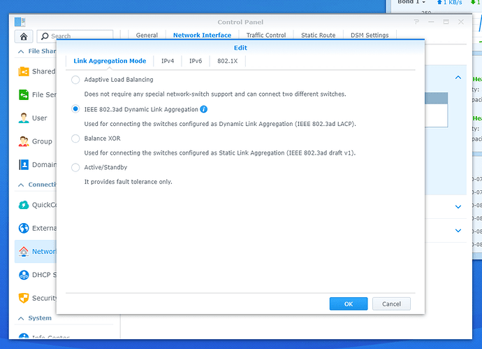

Other than the IP change I also implemented LACP on my switch and NAS. Are there any reports of LACP being an obstacle. In the past i had used XOR load balancing.
Yes its a 2 port LACP LAG. Both the switch and NAS see the LAG as up and operational, and I am not getting the error msg in red, on the NAS side that tells me LACP is not configured correctly.
Logs attached…Logs.zip (143.0 KB)
Here are some screenshots of my LACP setup on the NAS…

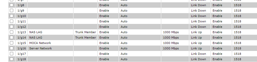

This is attached to a managed switch. Do you want screenshots of the switch side?
Yes…here you go…
