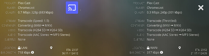

Audio is also transcoding to mp3. What changed recently for these transcodes to start? I can upload the debug log, if necessary. Screenshot of two streams from Tautulli:

The movie is 720x304@ 1271 kbps, audio is 160 kbps AAC stereo. I’m probably missing something big but that should fit well within the 2 Mbps budget. In reality both are transcoding, the audio to a different format, even.
The message you posted indicates the limit is set top 720kbps, not 2 Mbps. I would need the log from the Android app after you start casting this video again so I can see what’s going on.

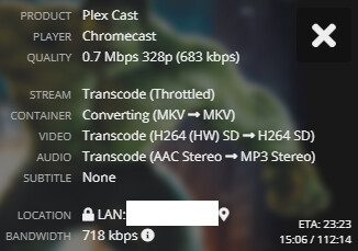

Te server is back up and I’ve reproduced the issue. I’m starting a Chromecast stream from an android phone, which has a 2 Mbps limit for remote streaming. All devices are on a LAN. Funnily enough the LOCATION field shows the WAN IP but I confirmed that all devices (the Android phone starting the stream, the server and the Chromecast playing it) are all on the same network. What looks suspicious is the bandwidth limit for cellular (0.7 Mbps) as if that was applying to LAN playback.
