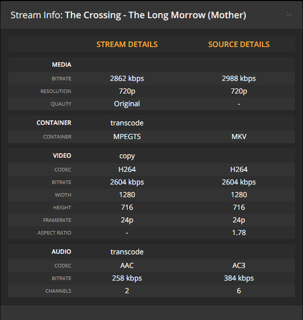

8:39 mountian time tonight, watching the crossing lasted 13 minutes & then buffering started.

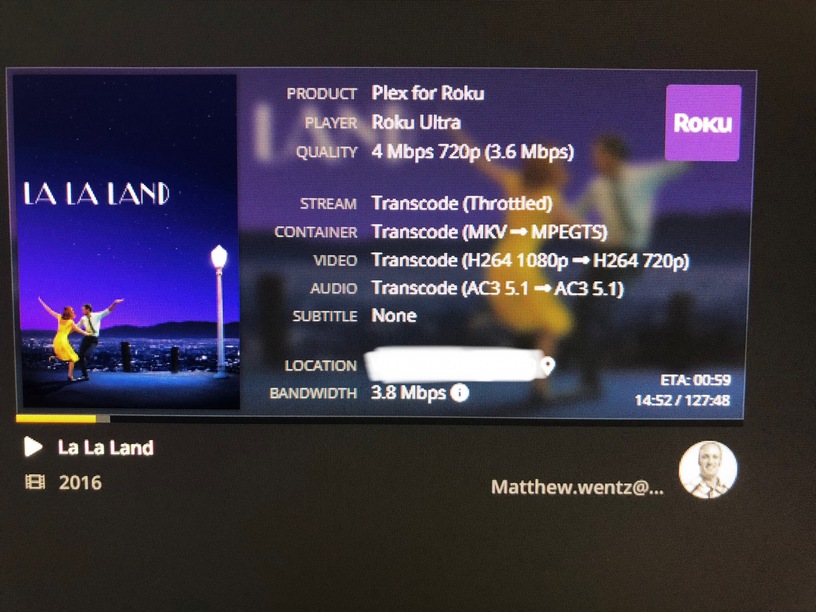

Justs did the same movie, running a 4Mbps stream and at 10:40 PM CST it buffered 1:07 in.
Just buffered again at 5:21 (10:44 PM CST)
And again at 5:30 sec

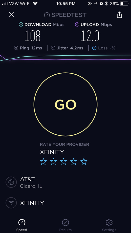

Speed test from my iPhone over wi-fi on the same router that my Roku is hardwired to. Just curious how it’s a bandwidth issue either at original resolution or 4Mbps unless I’m missing how Plex server works.

And this is the same movie, streaming at 4mbps

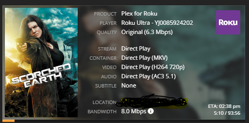

@ljunkie Watching your stream, you are on direct play. Set it to not allow direct play and the issue should start, usually in the 10-20 minute mark
My users dont have buffering issues with direct play…But their systems dont support the Audio, so i have to have them set to transcoading…

Specific Stream deatils on the last time they tried:
marliesheld@shaw.ca
and the other user skye-259:
