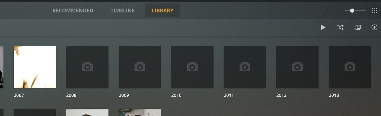

Hello everyone,
like the title says I am not getting thumbnails on some of the photo albums. I tried scanning, analyzing, nothing works.
I have errors in log files like the one below, but no idea what that means.

That’s very nice but I still can’t see them. I tried 3 different clients so it must be the server.

According to find and wc I have 20753 files in all the folders. How long “should” it take to scan on an i5 with over 2Ghz and plenty memory (inside docker container but without limits)? The server runs since yesterday. I think what you see in the logs is what happens after I click analyze? Well even if it finally finishes then I can’t see the thumbnails.
Photo processing included, unless you disabled it, tagging.
If you created the library, adding all 20,753 files at once, it will take a lot of time.
Rule of thumb is to add no more than about 5000 at a time from one or more subdirectories. It allows all the sub-phases of photo processing to complete quickly. Since there is no limit to the number of subdirectories which can be included in a section, there is no concern for having too many.

It is extremely hard to believe that it should take that long. The first album thumbnails were generated in seconds and minutes. In the past I had zero problems. I’m sure there is something broken in Plex.
Enough time passed and the thumbnails are still not there.
Anyone, anything? Days pass, thumbnails are still not generated. This is some kind of a bug.
