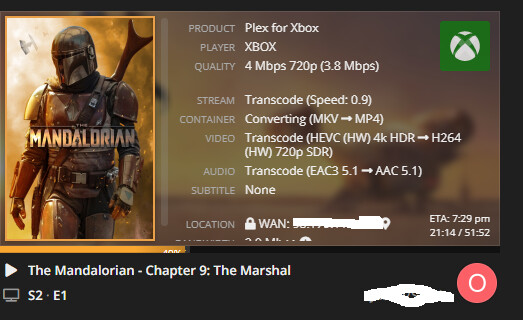

When I was doing CPU transcoding I could maintain about (2) x265 4K → 720p transcodes at the same time. Now that I have installed this new GPU and setup ESXi for GPU passthrough I am not able to do even a single 4K transcode without massive buffering.
I’m not sure what more is needed. Here are some screenshots and bits from the log. More verbose logging can be provided if needed.

This seems to be an ongoing issue for almost 2 years.

Hardly anyone ever does this, but I am here to report back on my findings. I have isolated this squarely to issues with HW transcoding on the windows platform. I rebuilt my plex VM on Ubuntu and I am now getting 8.0x speed on transcoding.
So I will consider this issue resolved.
