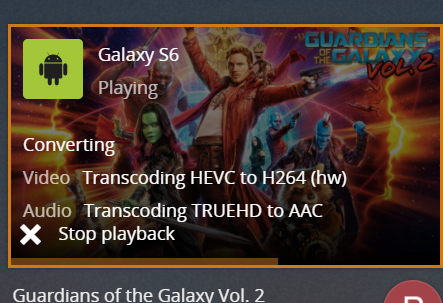

Just a quick update:
My rx570 arrived today, I installed the card and the 17.11.1 catalyst driver - I also saw an update for plex server with 10-bit support in the release notes so I installed that as well. I was able to playback 2 x 10bit 4K files simultaneously using android phones as the clients. My CPU usage stayed low, about 40-50% so this seems to indicate that things are working as they should.
I updated to Catalyst 17.11.2 and CPU usage lowered further to ~35%
Under 17.11.1 driver plex was showing “Transcoding HEVC (HW) to H264 (HW)” - but now under 17.11.2 the first HW is missing. Seems to be working anyway, as my driver and plex version are both beta I am not too concerned. I have not tried seeing how many simultaneous 4K or non-4K streams this can manage but things are definitely improved! I will try to attach some screens.
Additional screenshots:

The first HW is decode, the second is encode. Meaning on your second transcode the file was decoded by your CPU and the re-encode was done in HW on your GPU. Would have to see the logs to figure out why that happened. Was it the same file or a different one? Some codecs (VC1 for example) might not be supported in HW on that GPU.
I’m testing with the same three files each time: all three are 4K and 10-bit HEVC.
Today plex reports HW for both decode and encode and CPU usage is roughly the same. I suspect that more a bug in what plex is reporting. My next steps when I get some time will be to try and max it out. It looks like plex isn’t falling back on the CPU once the GPU is maxed.
