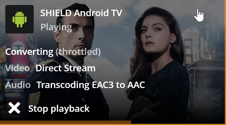

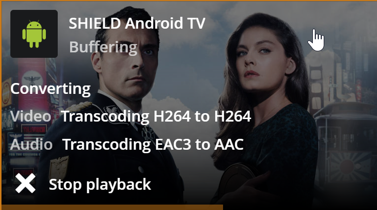

Here’s some images to explain myself a bit further. One is with subtitles activated, the other with them deactivated.

so with the shield connected to the tv, which does not support the audio stream, the shield knows this, which tells the plex server to convert the audio.
in your examples above, your shield client is accepting the video direct but the audio must be converted to a compatible audio stream (due to the tv).
when subtitles are enabled, for whatever reasons I don’t know, plex (server) is unable to either send or the client (shield) is unable to receiver subtitles with mixed conversion.
so with subtitles, the server starts to convert the video and the audio just so the subtitles can be displayed.
since your server is not powerful enough to transcode the 4k, that is why it buffers when subtitles are enabled.
Your solution is one of these options;
  1. choose an audio stream that is compatible so the audio does not need to be converted
  2. turn off subtitles
  3. buy a 4k/hdr/atmos receiver and put it inbetween your shield and tv.
I guess 4) is you could buy/build a server that is powerful enough to convert 4k, but then you lose both 4k and hdr, which makes the whole point of 4k moot.
that is all you can do.
