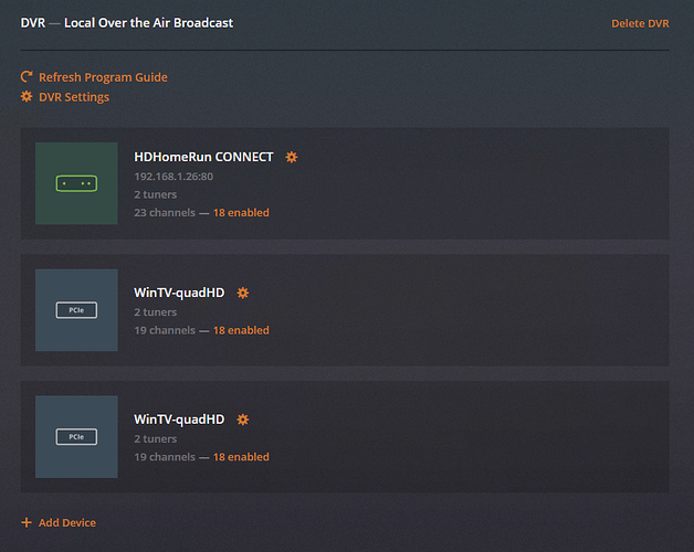

I am having the same problem with the quad tuner. I only show 2 tuners. Not sure why. Did you figure your problem out?
For the QuadHD you actually set it up as two tuners with 2 streams like this: maybe the Dual is like that too…

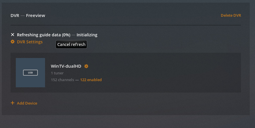

Did you ever find a solution to this? I think I’m running into a similar issue:
I’m running PMS on Ubuntu 16.04 within an LXC container.
I set up device passthrough for my WinTV-DualHD using /dev/dvb/adapater0/* and /dev/dvb/adapter1/*
w_scan sees and scans both adapters, as does dvb-tools.
Plex only sees one tuner.
If I install PMS on the host instead of the LXC container, then Plex sees both tuners. So it seems like it must be something with the device passthrough setup. But since w_scan and dvb-tools see both, I’m not sure what could be confusing Plex.

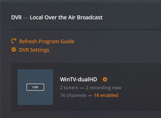

For what it is worth, my dual shows correctly.

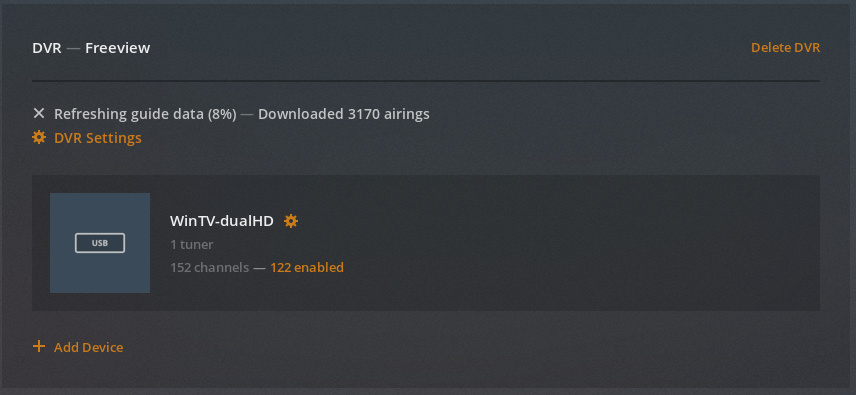

Thanks, however, it’s still showing 1 tuner. I updated my kernal to 4.17 (uname -a outputs Linux ihy 4.17.5-041705-generic #201807081431 SMP Sun Jul 8 14:33:41 UTC 2018 x86_64 x86_64 x86_64 GNU/Linux), however, its still showing 1 tuner. This is after i deleted the device and readded it. Any other ideas? It seems that 4.17.5 o 18,04LTS does not resolve the issue
I also rebooted and manually booted to the Hauppauge Kernal (thom@ihy:~$ uname -a Linux ihy 4.15.0-24201807041620-generic #0+mediatree+hauppauge-Ubuntu SMP Thu Jul 5 01:38:17 UTC 2018 x86_64 x86_64 x86_64 GNU/Linux ) however same issue. Both times i deleted and readded the device:
Thanks for any suggestions you might have.
