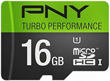

However I don’t know what SD Card to get for it.
Capacity - the image itself is 125MB, is anything else stored or cached on the SD Card? Does the required space corelates with library size on server?
Speed - what is recommended here? Class 10, UHS-I, UHS-II, UHS 3 ?
Brand will be most likely SanDisk as I have good experience with those.
Using that one in my Odroid C2 now and it works great. Class 10 UHS-I, UI

I just want to pop in and say that there is an issue with large libraries where thumbnails are not being deleted periodically. This functionality is upstream and can cause SD cards to fill to capacity when deleting/moving/renewing large amounts of artwork. I recommend a 16GB card now instead of the 8GB.
Want to add, I have tried several SD cards, and this one by far makes the Wetek Hub/OpenPHT very responsive;
SANDISK 32GB MICRO SD EXTREME 90MB/S UHS-I U3
This is a 90MB/s read and 60MB/s write speed.
Costs around 20eur.
