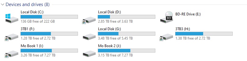

I’ve found a lot of topics about settings that are/aren’t ok and what will/won’t degrade your file. I have a fairly large hard drive and it’s only about half full, so I’m not worrying about storage space yet. I’m having a hard time playing some shows and movies and the culprit is usually the audio or video codec.
I’d like to just spend a few days transcoding my whole library into a file that Plex won’t have to transcode. It doesn’t have to make it smaller or anything, just changing them into the standard codecs and container that Plex and most devices will not whine about.
