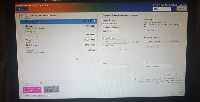

Servers are a pain to do anything but network boot XD anyhow, finally got my partitions set up, before I go ahead just wanted to see if you had any recommendations. Screenshot attached

No, you do not need anywhere near that level of subslicing in this arena.
Domestic & private server configurations run surprisingly problem-free with the 4 basic paritions.
