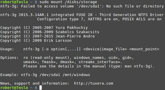

After executing “sudo find /disks -type d -exec chmod 755 {} ;”:
When I try to mount the Storage drive:
Also, this happens when I launch Plex:
Thank you for posting that. Those filesystems which are NTFS will produce this error. There is no harm.
