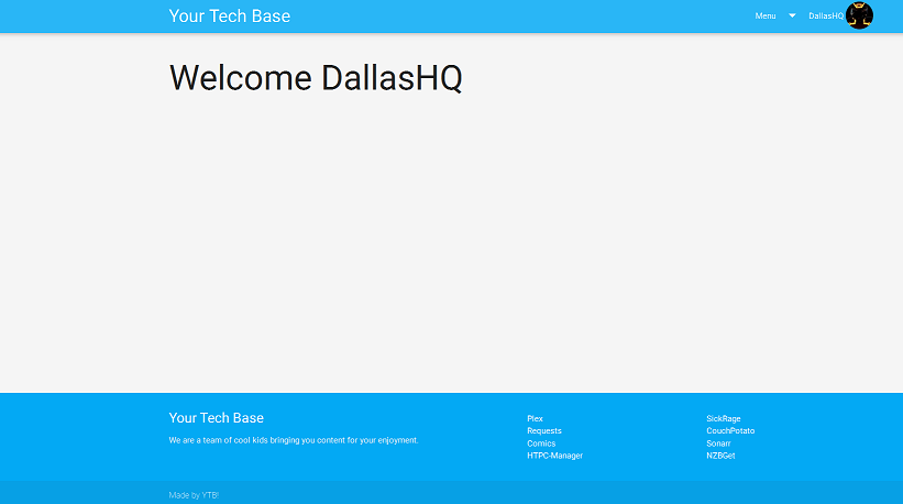

Big shout out to the developer of this great solution, was stuck on a weird 401 issue for days (was able to login via other methods) via auth_requests module. Developer helped me out from the beginning to to the end, he went out of his way so I appreciate that. I was able to successfully link Nginx + plexauth to utilize php iFrame solutions such as Muximux. If you are running everything off one domain with web paths (no subdomains) then I recommend you check out the dev’s latest nginx example found on his github or this pastebin: http://pastebin.com/JCuG8TPN. Please note he does have Nginx examples for a subdomain setup. Lastly, you don’t have to utilize his launch page either (which is good), you can replace the launch page with Muximux/ManageThis etc… The developer will have more tips on how to do this on his Github.
