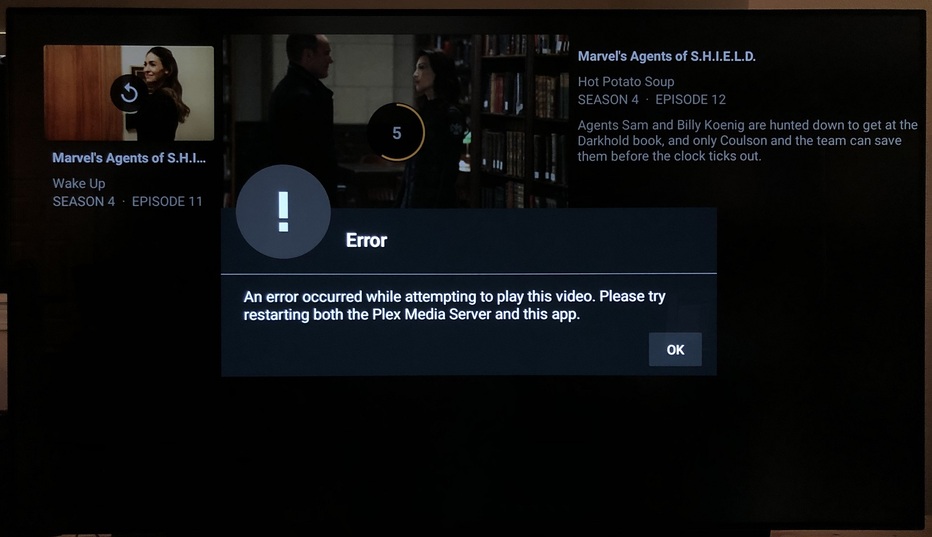

Problem: Play “Up Next” does not work. After a TV episode, it shows the “Up Next” screen with a countdown but an error message pops up reading “An error occurred while attempting to play this video. Please try restarting both the Plex Media Server and this app.” After the countdown, the screen behind the error message goes black but the error message remains.
I have restarted both the app and the Plex Media Server but the error keeps recurring.
Screenshots:
Client version 8.3.0.18653 beta. (Nvidia Shield Pro 2019)

I disabled the New Player in the settings and Plex plays Up Next instead of giving me an error.
Problem comes back when I enable the New Player in the settings.
I realize that is not a fix, but it is a data point.

More information: I have subtitles on by default. If i disable the subtitles on the episodes I want to play before I play them, then I do not receive the pop up error. Instead, the countdown on the “Up Next” screen finishes and the next episode comes on but it does not play automatically. It is paused. I have to manually hit play for the episode to start.
Either way, it is still not functioning like it used to.

As I mentioned in a previous post, when I have subtitles enabled on the episodes, the popup error comes up saying “An error occurred…”, but that popup does not happen if I have subtitles disabled. In both cases, the next episode does not play and I have to hit the back button to be able to do anything.

Seems to be working now in the newest beta. It does do a weird behavior now where it starts the next episode before the count down ends. So when it opens up the next episode its already like 8 seconds in.
Yes I am gettig the same problem as @Sittingmongoose. The next episode starts straight away underneath the countdown. When it does get to the next episode the aspect ratio is incorrect. Afetr finishing Watching a 16:9 SD program the up next screen comes up and the next episode starts underneath the countdown screen. When the countdown screen disappears the 16:9 program is squeezed into a 4:3 pillarbox. It appears as though the graphic is a true 16:9 ratio whereas the program is a 16:9 ratio squeezed into a 4:3 raster. The next episode just isn’t unsqueezed in the player as the overlay was a different aspect ratio.

The error seems to be fixed, for the most part.
There is still an odd occurrence when the next episode plays: The video starts on a frozen image that appears to be about 5 seconds into the episode. The audio plays normally and once about 5 seconds has passed (catching up to the frozen frame), then the video and audio proceed as normal.
While I don’t find this ideal, it is a much better situation than the next episode not playing at all.

It’s been a week and the “up next” feature seems to be working again. Marking this as solved.
