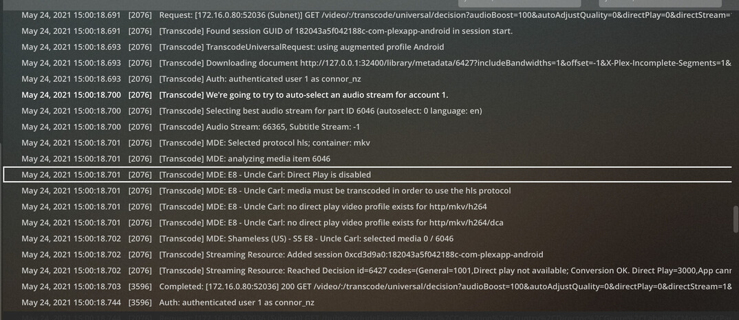

Plex app working great expcept won’t play the next ep to a series and displays " An Error Occurred While Attempting to Play Video"
I’ve gone through troubleshooting, changed passthrough settings. I can’t change the player from new to old as there is no settings in the advance settings.
I’ve rest the android app completely and set it up - and still no go.
I haven’t had it long so I don’t know if this is a new problem or something that has existed before.
Looking in the logs - it looks like it’s trying to transcode? But when I go back into the season and select the ep, it plays fine and on the Plex dashboard, it shows the ep playing with video and audio on direct play… I’m at a loss

Androidtvlogs.txt (1.2 MB)
Thanks. I see the error. Have no idea what is causing it. Will bring it up with the dev team.
